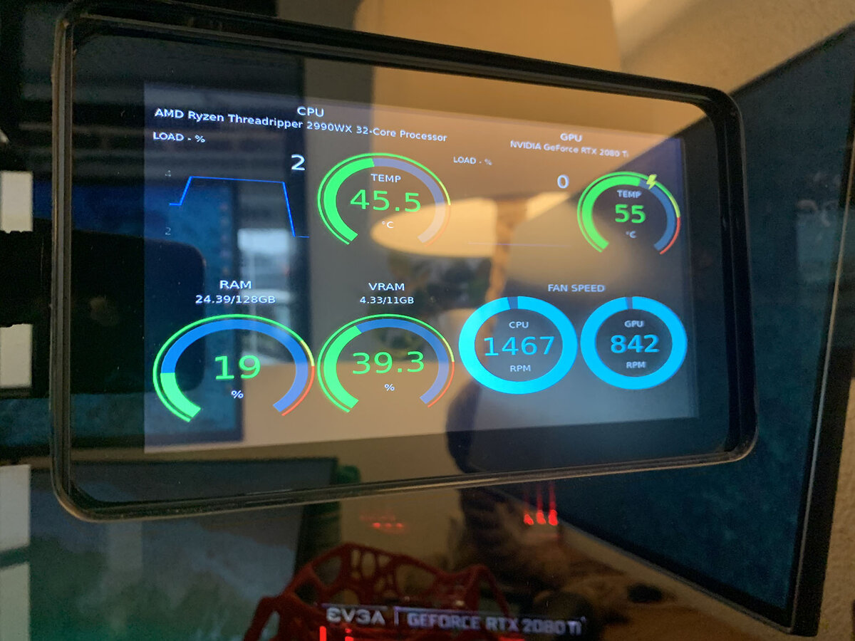

I should mention that the current setup I have is a 7" screen displaying the “dubbadher” theme within a PC case with the Raspberry Pi 4 directly behind it connected via HDMI cable & USB for power and the ModBro app on the PC running Windows 10.
